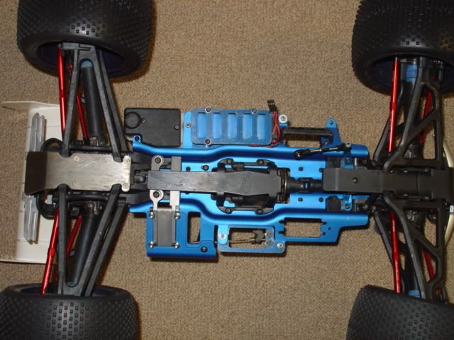

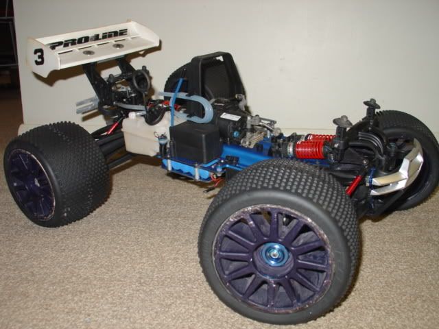

I just bought a roller! It will ship out monday. I have a sheet of 3mm CF on the way and an RC-M motor mount on the way that should arrive monday or tuesday.
the roller starts it new life as:
· Traxxas Red Aluminum lightweight pushrods and turnbuckles
· Front RPM arms- black
· Rear extended Traxxas Arms
· Tekno wing mount with Pro-Line Wing-white
· Xtreme Racing Carbon Fiber Rx box and battery mount- blue
· Xtreme Racing Carbon Fiber throttle servo mount- blue
· RPM axle carriers- black
· RPM receiver box
· Pro-Line 40 series Bowties on Wabash wheels
· Pro-Line 23mm hubs
· Pro-Line aluminum steering arm
· Aluminum Rear skid plate
· Brand new bumpers and front skid plates
· Stock battery & Forward only conversion

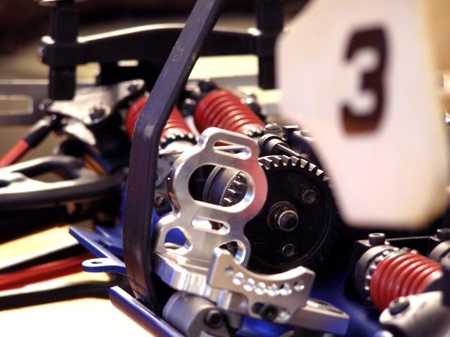

Today my lunsford pins and Revo arrived!

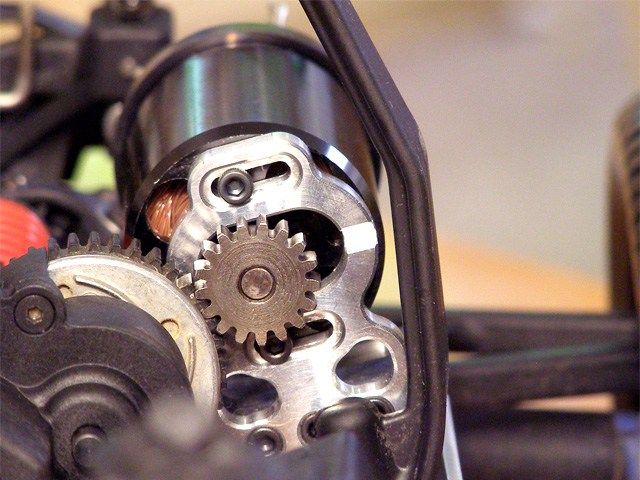

I stripped the nitro gear off and installed the rc-m mount.
Keeping the nitro tranny. Thanks Mike @ Rc-Monster for the mount.

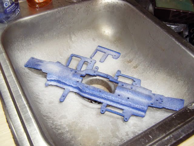

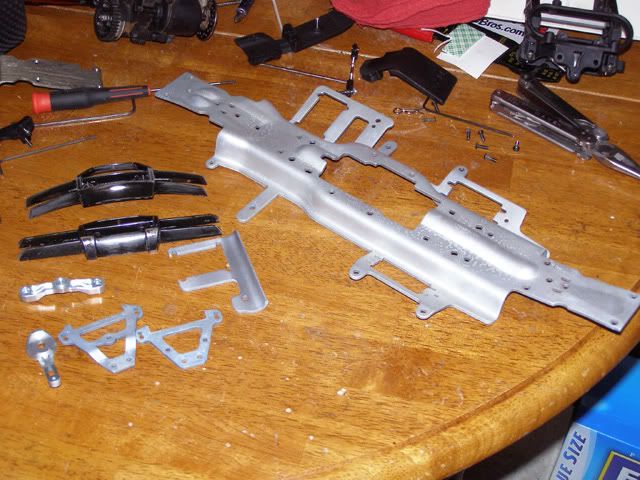

I've been busy this evening and the truck is looking great. The anodizing all came off really easy but the fumes made my head all loopy.
chassis having an easy off oven cleaner soak:
All the parts I stripped:
Back together as a roller:

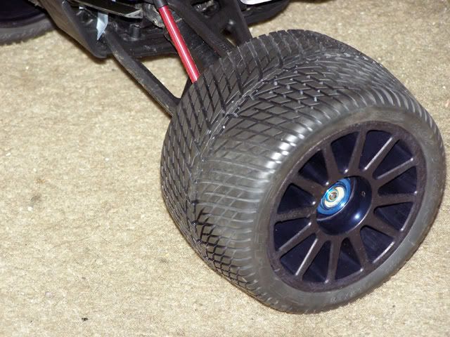

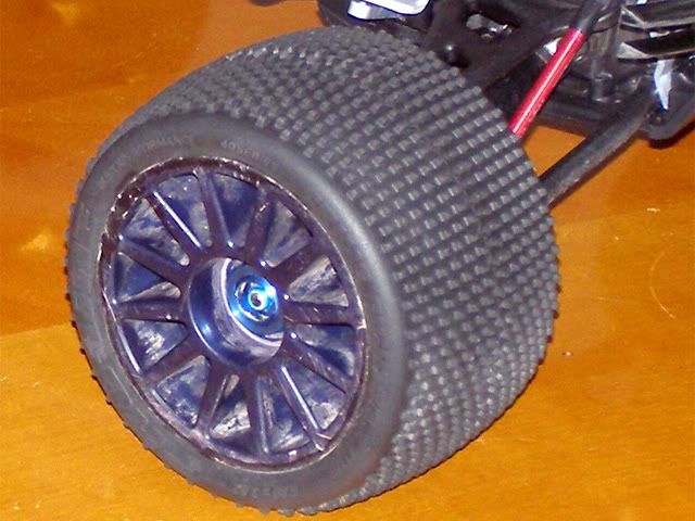

My wife got me 40 series Road Rage II's and some black rit.
Before:
After:
much better!
now i just need to work out an off road tire choice.

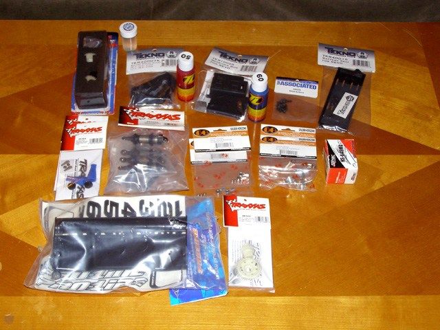

goody box came today via big brown truck
contents:
*Tekno RC Battery Straps (black)
*Tekno RC Battery Tray (Revo)
*Tekno RC Receiver Box for REVO
Golden Horizons Aluminum Shock Caps (Revo, Jato, silver)
Golden Horizons Aluminum Shock Rod Ends (Revo, Jato, silver)
Hitec HS-645MG High Torque Coreless Servo
Pro-Line 1/8 High Downforce Wing (black)
Team associated Button Head Hex Screws (M4 x 10mm, 10pcs)
Traxxas GTR Shock Boots (pair)
Traxxas GTR Shocks (assembled, aluminum, hard anodized)
Traxxas REVO Center Differential Kit
50wt oil
60wt oil
300k diff lube
wide ratio gear kit.

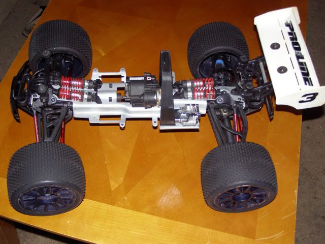

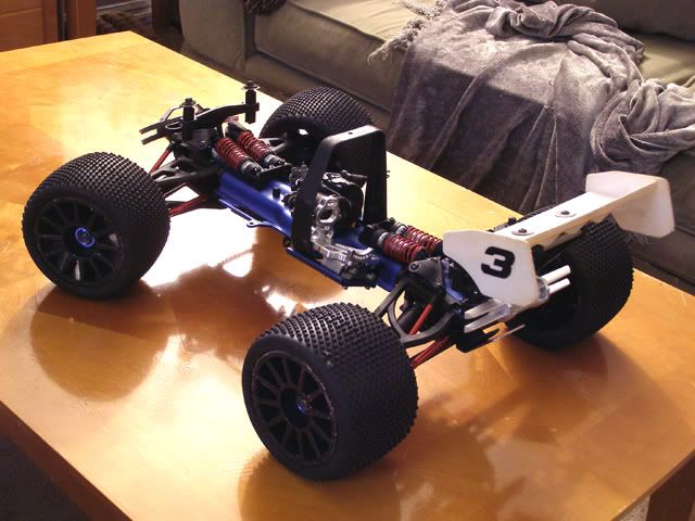

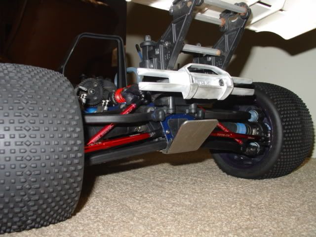

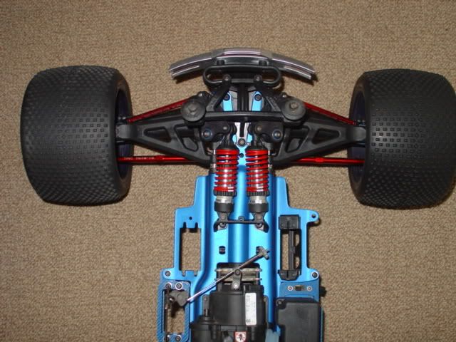

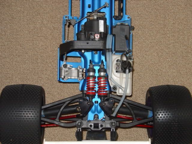

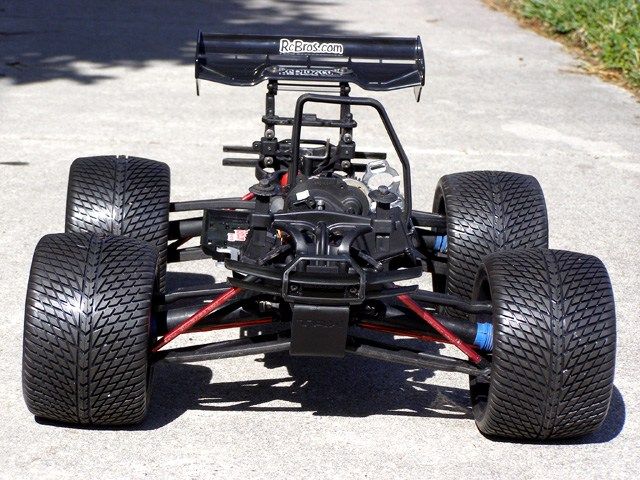

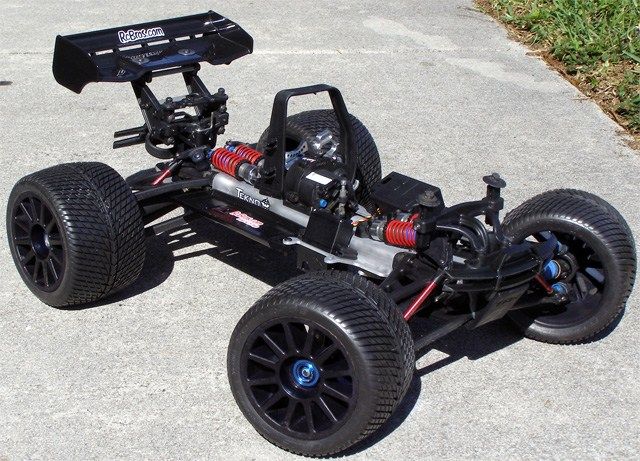

I did some wrenching on it this weekend. I still have to tear into the tranny, but it looks a bit different!

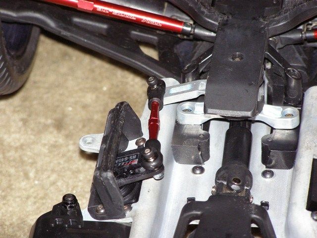

1 rustler front red tube + 2 revo gtr shock ends = matching revo steering linkage!
That's cool Dan. I could have mine running tomorrow if I wanted too. Buy an 8xl and use my MM on 12 old beat nimh cells. but I'd rather save and do it right the 1st time.

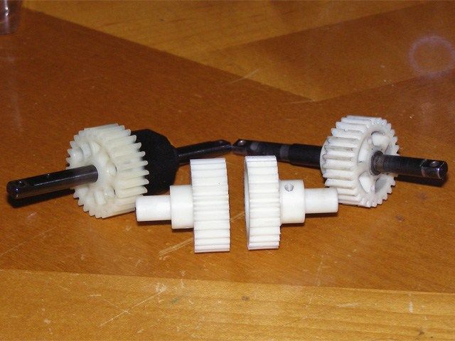

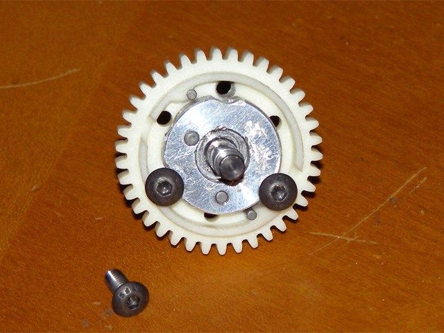

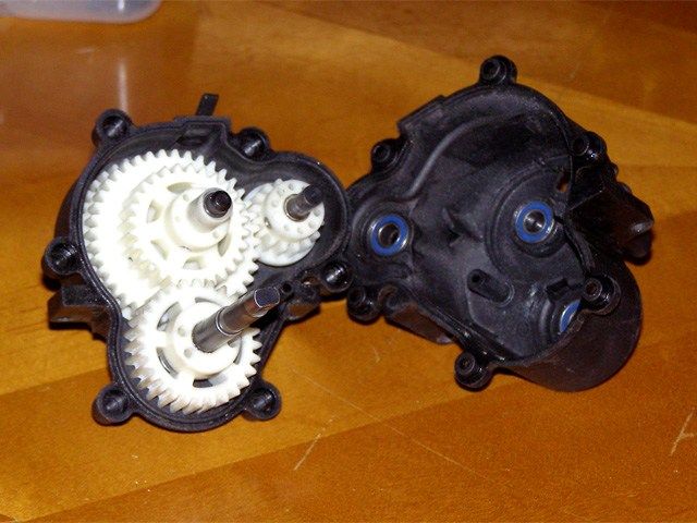

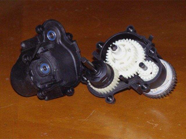

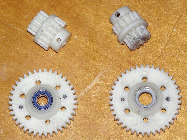

Did the tranny work today.
Stock:
Wide ratio:
Center diff:

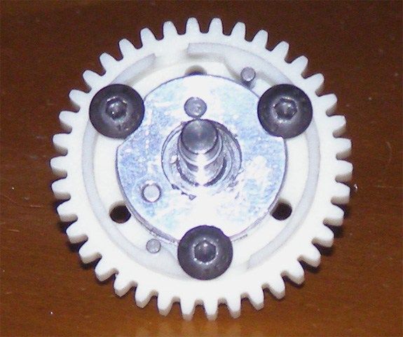

2nd gear locked, I'm trying it with the centrifugal clutch locked in rather than against the pin. If it hold's, great! if not I'l get another disk and redo it. I clamped it in a vice and connected an 18v drill to the shaft. no flex at all.
Finished, 1st gear removed:

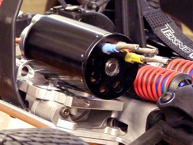

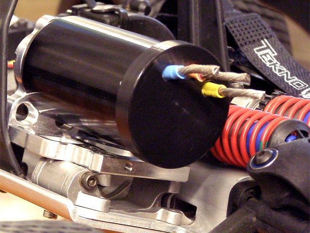

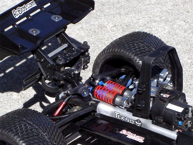

My Neu 1515 1y/s came today!
front, I have a cover on the way.
rear, no dust cover
rear with dust cover

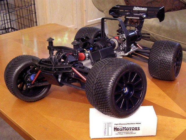

Neu Revo!

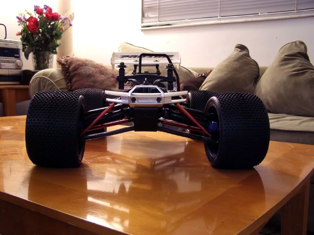

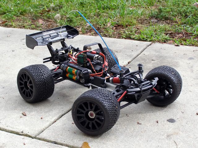

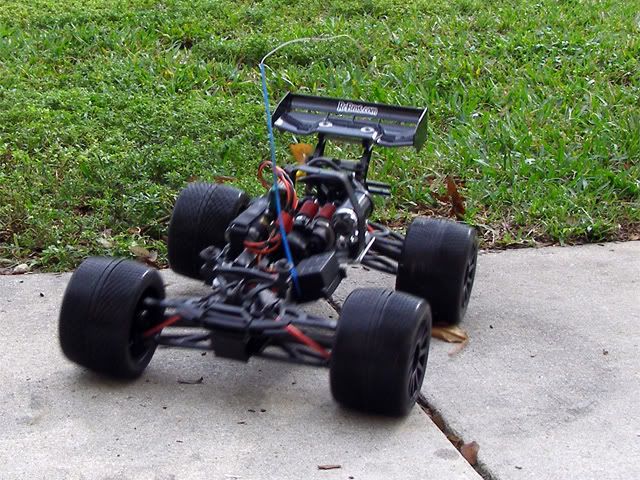

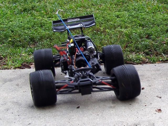

Still missing lipos and an MMM, but it runs! 12 very old and tired nimh and a MM with no ubec. GriffinRu has my MM right now performing his stage 1 mod. lipos get ordered next Friday.
pardon the messy wires, this is just a mockup, they will get cleaned up.
temps after 12 mins were batts 114, motor 109, esc 111

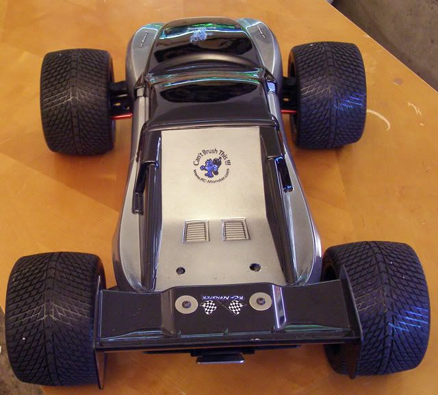

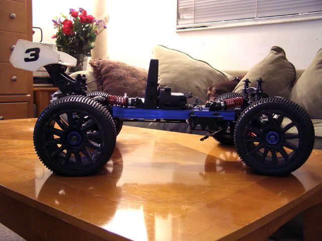

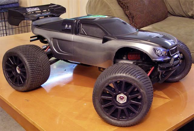

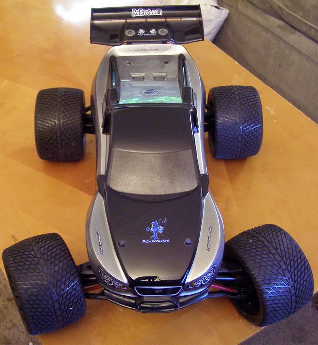

got a shell for it:
