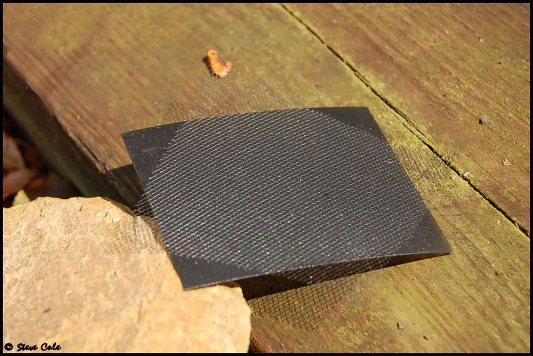

Galera, peguei esse tuto em um site gringo. bom, vou traduzindo de pouco em pouco. se alguem quiser ajudar a traduzir, manda os trechos traduzidos pra min por MP, junto com os em inglês.
espero que gostem
Citação:
Aparentemente facil de fazer, mas precisa de um pouco de tempo.
Tintas Necessarias:
  • Clear Coat
  • Charcol
  • Black (tanto faz)
Fabric:
  • Tulle (peça que vai na cabeça da noiva)
Ferramentas Necessarias:
  • Tesoura
  • Fita
  • Um pequeno pedaço para pintar.
You can get the fabric at any local fabric store for cheap. By me I can get a yard for around a buck. Which will last you a long time. The fabric is really just small squares. Its pretty much a small mesh that is used on wedding dresses.
Step One:
Mask off every thing but what you want to do this tutorial to do. Make sure you get every thing cause you'll be spraying paint which can go every where. Take your tulle and cut it to the size you need. Now keep that around you where your painting so you have it in an easy reach.
Step Two:
You will need to work at a quick pase for the next few steps! You don't want your clear to dry while your laying down your Tulle.
Take your clear and spray your area well. Make it even. Let it dry for around 5 seconds. Thats rough just enough time to get the tulle that you should have pre-cut and lay it over it the are you sprayied the clear. Make sure its fairly flat. Now spray a thin coat of clear over the area that you just laied your Tulle. Once you sprayied the second coat of clear work fast and brush from the center out pushing down the Tulle. Make sure you get it into the edges say of a hood vent. You want to have the cf every where. If you don't have the Tulle down flat you'll have areas where they will be one color.
Now wait a few minutes for the clear to fully dry.
Step Three:
Now that you're done probably the hardest step here, take your paint can or air brush, which ever you use and spray your charcol color frist. Do a light coat and then cover the area trying to keep it even as possible.
You should end up with something close to this.
Backside
Step Four:
Be extra carful removing your Tulle. Now remove the tulle but be very very carful that you don't ruin your pain you just laied down.
Step Five:
Now that your removed the tulle go head and paint your black. The black makes the charcol a darker color while filling in the area that the tulle was.
Finial Photos:

só não entendi q tinta e q cor ele usa pra passa a primeira camada la no começo....

Cold, este tudo é para pintar "igual" a fibra de carbono...
Isso é beeeem fácil...hê hê hê
Basta pegar uma telinha, pintar de cinza, depois tirar a tela e jogar preto...
Agora se você quiser quiser REALMENTE fabricar peças em fibra de carbono, a coisa é um pouco mais complicada, mas nada de outro mundo....

é pra pintar a bolha. pra ficar um Drift Style. hehehe

mas qual são as cores que ele usou, não entendi direito :lol:

o cara usa, preto, cinza escuro e tipo um verniz. sei la. esse clear coat que não sei o que é.

então é essa mesmo que estou com dúvida
pois a colorgyn tem um verniz especial pra plástico e propiletileno :D

no filme mostro q usa uma tela que eh quadriculada, tipo um quadrado cheio e um braco quadrado!
onde acho essa tela???

Para a tela, pode usar filó (é um tipo de tecido bem aberto, pergunta para sua mãe que ela te explica melhor).
O Clear Coat é verniz incolor. Só será necessário se a pintura for feita pelo lado de fora (pouco durável). Pode usar qualquer um que seja brilhante, flexível, dê boa aderência sobre a tinta escolhida, e que não provoque reação com ela. Sugiro verniz bi-componente, mas precisa de aerógrafo para aplicar.
Fazendo o trabalho pelo lado de dentro da bolha, o Clear Coat é desnecessário, pois a própria bolha vai dar o brilho.

Filó?? E fica bom??

Tem que procurar o tecido com a trama certa. Filó tem em diversas "aberturas", algumas podem ficar fora de escala...
Uma outra alternativa é usar tela tipo "mosquiteiro", mas vale a mesma sugestão, procurar a trama certa.

Tela de mosquiteiro é muito "fechada"
